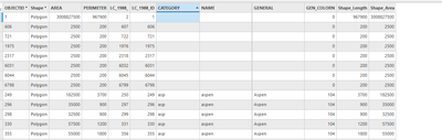

This is what my table looks like before calc field:

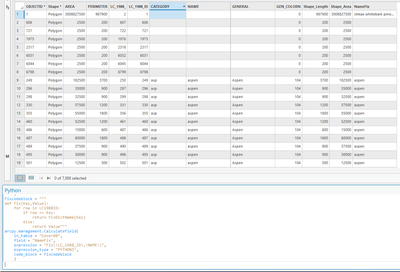

If I include the else statement, only field in the list populates correctly:

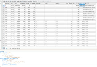

But, when I delete the 'else' statement, the new field populates correctly off the list (of course omitting all the remaining fields)
