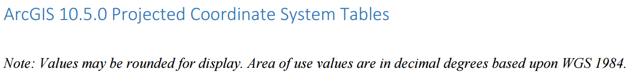

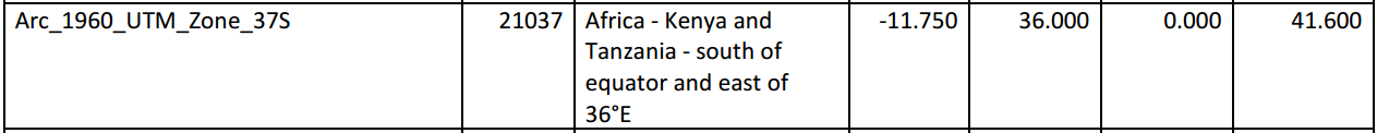

I was hoping that by comparing the spatial extent of the shapefiles\CAD drawings with the extent of the coordinate systems (i.e. Arc_1960_UTM_Zone_37S, WGS_1984_UTM_Zone_37S) I would be able to determine the correct coordinate system. The first problem is that the extent is in decimal degrees and for some reason or other they are in WGS 84.
Projected Coordinate System Tables: values are based upon WGS84

Most of the extents come from the EPSG Registry. They are consciously given very roughly and are the bounding boxes of a set of area polygons. Esri doesn't use the polygons (yet). They're also all in WGS84 because if you used different GCS, you'd have to also state which transformation to use to get them to WGS84/ITRFxx. The extents are imprecise enough that it doesn't matter.
You won't be able to differentiate UTM zones based on different GeoCRS unless the data itself shows the same location AKA has the same extent once you put them into the same GeoCRS.
