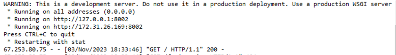

I've developed a REST service that uses flask and runs in flask's development environment without issue. It is installed in a ArcGIS python clone, using the arcgis, arcpy, flask packages. In development mode I see the following. Note it responds properly with a 200 response when queried by a client.
Screen Shot 2023-11-03 at 4.34.08 PM.pngScreen Shot 2023-11-03 at 4.34.08 PM.png
I then try running the app using the only production WSGI server available via ArcGIS Pro's Package Manager. I get the following error.
