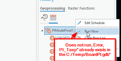

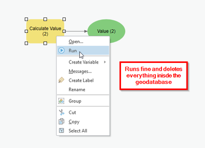

The odd thing that I noticed is if I select the Calculate Value Tool in the Model Builder View window, right click and select run, its runs fine, everything gets deleted. If I right click on the Scheduled Model with this Calculate Value Tool in the Scheduled Tools window and selecting run, I get a warning that, "PI_Taxp" already exists in the C:/Temp/BoardPI.gdb". So it's not being deleted.
So it appears that if it's scheduled in a Pro project, it doesn't run...?

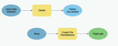

After setting up the model to use the delete tool and create file geodatabase tool, then scheduling it to run this morning, I get the warnings, the geodatabase already exists and so does the PI_Tax feature class. So nothing was deleted.

Don't know what to tell you.  If you add a precondition like I did in the example above so that the delete has to succeed before the create, then there is no way it could still exist unless you are working on different datasets or maybe some lock files are in place (though, shouldn't succeed in the delete if that is the case).
What happens if you make a new model with the delete tool, then create tool?  If that works, there is something else going on in the model/code somewhere.
Also, sometimes it helps to export the model to a python file as it can make it easier to see/notice path mismatches and such.
