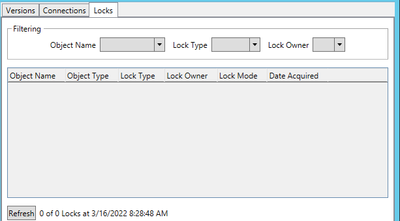

OK so its telling me its locked but I have already cleared the locks....there is no service hitting this db and its on a test box so nothing should be accessing it....
  • I first check to make sure it exists
  • I then try to disconnect all users
  • I then test that specific FC for a lock
It keeps telling me its locked but when I check the DB and FC after it runs there are no locks?
