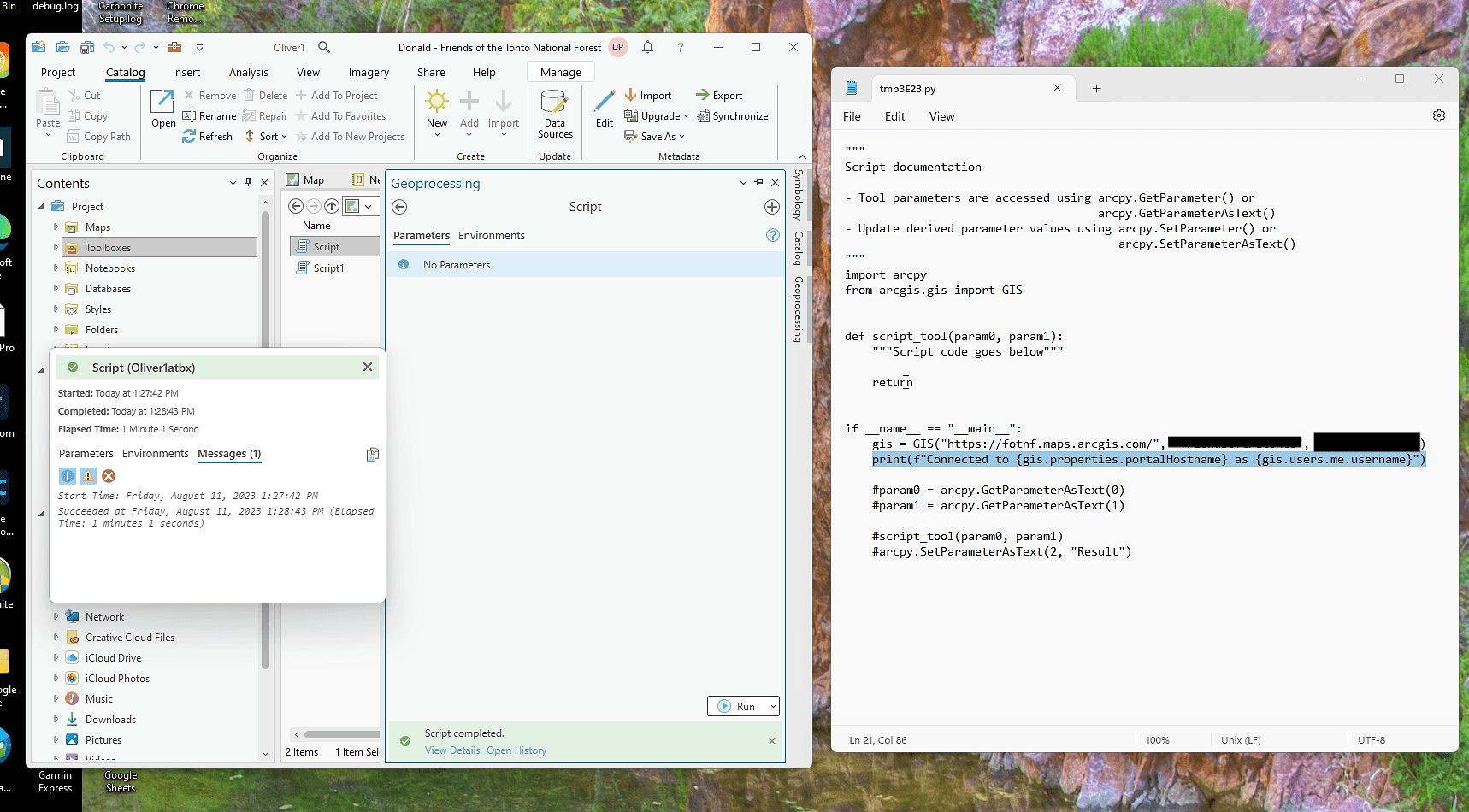

I'm investigating the capabilities of running a python script through a toolbox. I have a very simple script that appears to complete successfully, but as I get into writing more complicated logic, I'm wondering what techniques there are for debugging python toolbox scripts? I tried putting in a print() statement but I'm not able to figure out where I can view that output (if anywhere). If print statements can't be used, what are other techniques that can be used to debug scripts?
Here's a screenshot of how I'm running a simple script and the code it contains:

You need to use AddMessage.
I use this function to cover tool and standalone scripts... just pass it a text `msg`

The tools don't use the Python Window console, you aren't able to see print() output. Instead, use arcpy.AddMessage():
# bla bla
arcpy.AddMessage("This is a debug message, all is well...")
# bla bla
The messages will be visible in the tool's details:

For debugging your main code block, use the arcpy message functions to write to the geoprocessing history output. For debugging code in updateMessages() when validating parameter inputs, I use the message methods on the parameter object to output debug info to the little tooltip messages that pop up on the tool interface in ArcGIS Pro. It looks like your toolbox doesn't have any parameters, so you might not need the parameter messaging.
