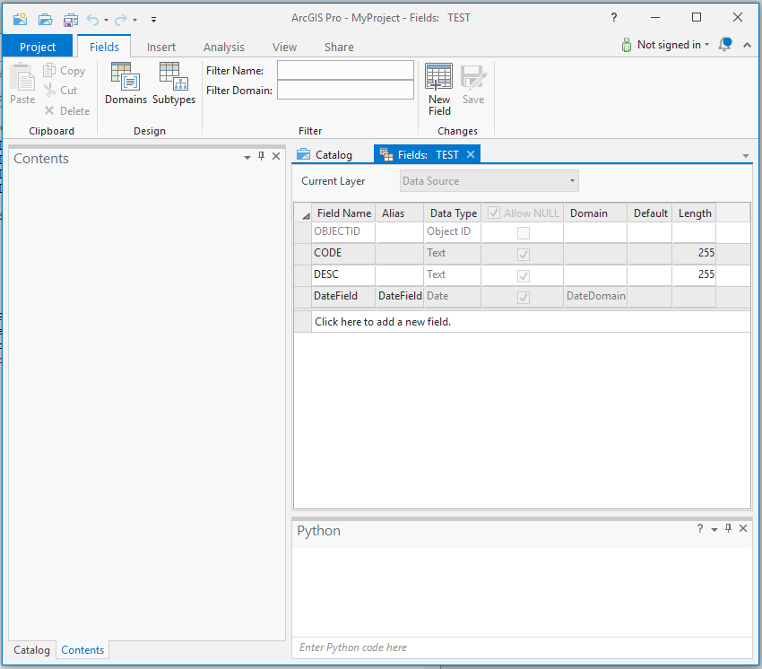

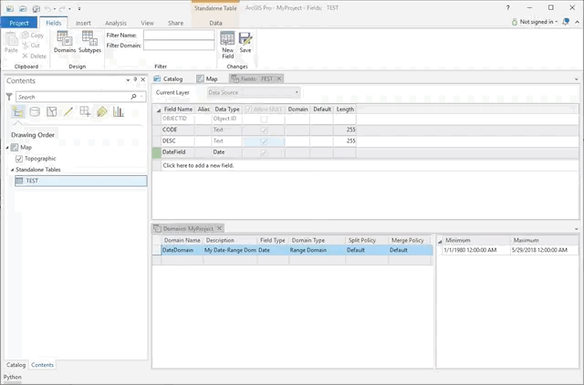

I then tried performing the workflow completely through the Pro UI and discovered that after I'd created the 'DateDomain' domain manually, I couldn't assign it to my 'DateField' through the Pro UI. (The circles are my mouse clicks)
So, in this case I jumped back to Step 2 above and executed the SetValueForRangeDomain_management tool to set 'DateDomain' on 'DateField' and it worked, or at least didn't return an error and when I looked at the Field Design for the TEST table, 'DateDomain' was indeed showing as being assigned to 'DateField'.

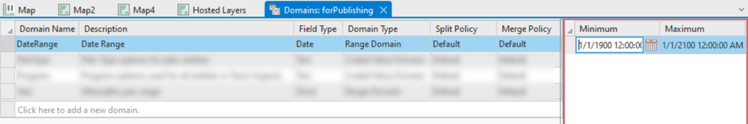

And if you want to do it in the GUI, if the Field Type is "Date" and the Domain Type is "Range Domain", then when you click within the Minimum or Maximum cells, there will be a GUI calendar input where you can select the date.
