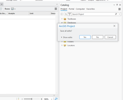

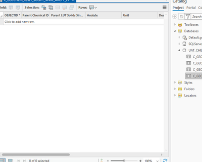

1.In Pro I select all in the database table and click delete, and confirm.
2. Save(?). It saves something, I am prompted, but not sure what (is saved)
Here a loading bar comes up saying "saving" for a second (not shown). The table is empty.
FYI only, as closing like this refreshes the data: but I don't want to have to restart.

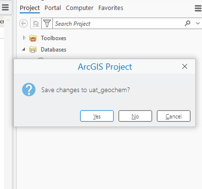

When closing instead I get two prompts
And then
Pro would now close - in theory. We are trying not to close it every time.
3. Run Query - Data is returned!

This is same item at the top of the list in the first screen shot.
('Total Sample Weight', 'Kg', 'Sample Weight Total: The total mass of the sample before processing.', '32', 32.0, '1111 ', 'gggg')
These inaccurate results should not happen. Is there anyway to make the empty state proliferate?
