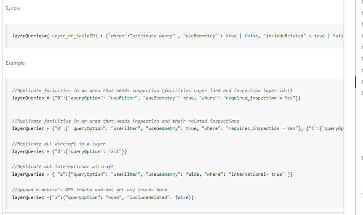

As you can see below the documentation uses queryOption and useFilter as well as a where clause... but I error out when I put those in my script...
NOTHING works except queryOption = all --- which then negates ANY use of geometry or where clause... ugggg
*** I really need the WHERE CLAUSE because I have attachements etc and dont want to download any unnecessary data...
Trying to use something like this but nothing but ERRORS -- It will not accept queryOption parameter of 'useFilter' as seen in the documentation above...

Anyone have any thoughts on using a WHERE CLAUSE
EarlMedina
Sorry, with respect to documentation REST API documentation IS NOT 1-to-1 with ArcGIS API for Python documentation. REST API parameters follow camel case, while ArcGIS API for Python follows snake case (as is convention for Python). Notwithstanding, as the Python API is a wrapper for the REST API it is useful to refer to the REST API documentation in cases where more details are needed on a parameter's usage.
My apologies if that wasn't clear before. You do have to do a bit of translation yourself or else have access to a good IDE that will point out such problems.
As for you layer query, I might have missed what the problem was earlier. You don't even have to include queryOption for your case if all you need is a where clause. You can just do:
{"0":{"where": "IMPORTED = No"}}

As of now this is the only syntax that seems to work
{"1":{"where": "IMPORTED = 'No'"}}
