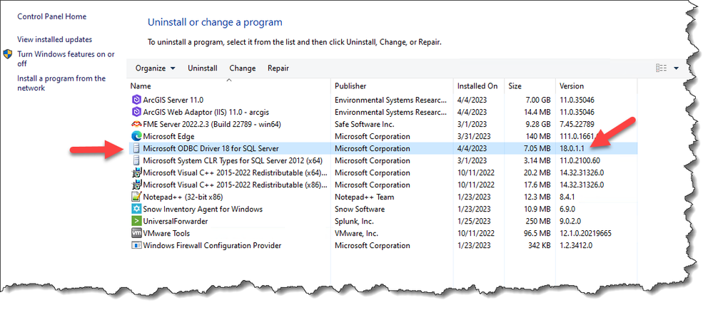

Following the recommendation of the page https://enterprise.arcgis.com/en/system-requirements/latest/windows/database-requirements-sqlserver.... I downloaded from Microsoft site the latest version of the ODBC driver version 18, that is the one that I installed in both machines (Client and Server):
A colleague  recommend me to install the ODBC driver provided by ESRI, I proceed to install it:
Now the result of the snippet is the one expected:
Conclusion: ArcGIS server 11 has an issue with the ODBC Driver version 18.6.3
