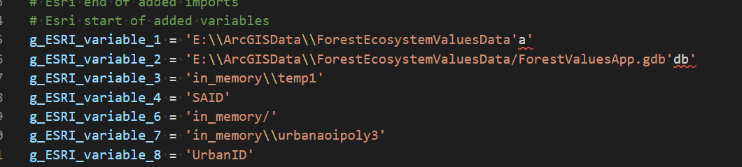

And when I open the script on the server folder I have this, it adds a string (a') to one of the variables and another string (db') to the other variable:
g_ESRI_variable_1 = 'E:\\ArcGISData\\ForestEcosystemValuesData'a'
g_ESRI_variable_2 = 'E:\\ArcGISData\\ForestEcosystemValuesData/ForestValuesApp.gdb'db'
g_ESRI_variable_3 = 'in_memory\\temp1'
g_ESRI_variable_4 = 'SAID'
g_ESRI_variable_6 = 'in_memory/'
g_ESRI_variable_7 = 'in_memory\\urbanaoipoly3'
g_ESRI_variable_8 = 'UrbanID'
And this is the error returned on the app:
File "E:\arcgisserver\directories\arcgissystem\arcgisinput\ForestEcosystemValues\EcoNewGP.GPServer\extracted\p20\forestecosystemvaluesdata\LATEST_CHANGEURBANNOPARAMS CLEAN NO PARAMS3.py", line 5
SyntaxError: invalid syntax
My coworkers are able to publish the geoprocessing service with no errors. What is going with my publishing? Thanks

I think we are suffering with the same issue. Are you publishing using ArcGIS pro 3.*?
WilsonIonara
Yes, but I tried with ArcGIS Pro 2.X also and then upgraded to 3.1.0 but I am still having the same issue.
