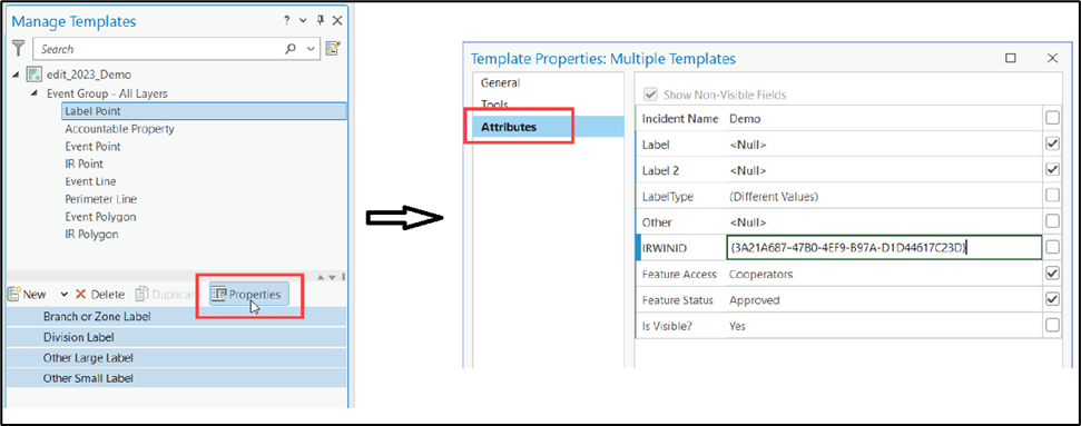

I'm looking into generating Feature Templates with a specific field value for users/editors to access when generating features in feature classes of a geodatabase. I need to be able to set various fields to a specific configuration of  values that will change periodically, so I want to script the update in Python.

I am trying to do pretty much the exact same thing, create a feature template for points with pre defined set attributes for each point that I have already loaded into the appropriate domain/field group/contingent values. Since there is a lot of points and fields it is a tedious process but doesn't seem like as straight forward as I would have hoped.
