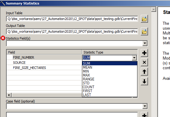

I would like to reproduce and enhance the behavior of the Summary Statistics tool in my own tool.

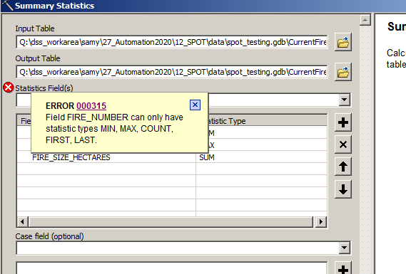

Currently, the summary statistics tool provides the same choices in the statistic type drop down list regardless of the field type but throws a 000315 warning message when the selection is in contradiction with the field type (i.e. valid statistics for text field are min, max, count,, etc...).

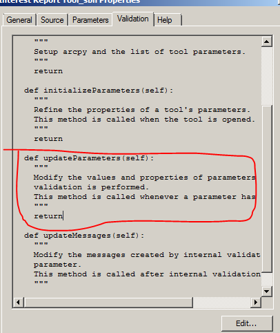

   - I suspect the def updateParameters(self) of the validation is where everything happens but I am having a hard to figure it out. Has someone done something similar?
