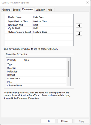

for the tool I have set the following parameters
where Output feature class is an output and everything else is an input

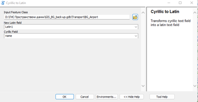

 when I run it  the expression is supposed to take input Cyrillic field and copy it to a new field, but I receive the following error:
Executing: CyrillicToLatin "D:\ГИС Пространствени данни\GIS_BG_back-up.gdb\Transport\BG_Airport" Latin1 name
Start Time: Tue May 17 16:24:38 2022
Running script CyrillicToLatin...
Failed script CyrillicToLatin...
File "D:\ГИС Пространствени данни\Toolboxes\Python scripts\cyrtolat.py", line 98, in <module>
expression_type="PYTHON_9.3")
File "c:\program files (x86)\arcgis\desktop10.8\arcpy\arcpy\management.py", line 3646, in CalculateField
raise e
ExecuteError: ERROR 000539: Error running expression: name
File "<expression>", line 1, in <module>
NameError: name 'name' is not defined
Failed to execute (CalculateField).
Failed to execute (CyrillicToLatin).
Failed at Tue May 17 16:24:39 2022 (Elapsed Time: 0,55 seconds)
where "Latin1" is the new name I have given for the Latin field, and "name" is the existing Cyrillic field selected from running the tool.
I suspect that the problem comes from defining the two input fields as fields and using them in the expression, however I cannot figure out how to correct it.
Any suggestions would be greatly appreciated!
