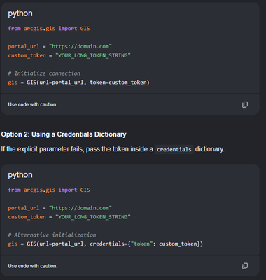

kapalczynski
Yea I had that originally and it did not work... was getting errors... google suggested the way I am doing it now.
I am going to test again and see what error it is throwing...
kapalczynski
Line 14 prints the token I am receiving...
Line 16 seems to fail : gis = GIS(url=portal_url, token=custom_token)
BUT you can see from the error that the correct token is being printed... its a valid token
custom token xQiM4Ft72qRDLEmW9BOTojBmvVMHp2YGEwBXTyIHrf3eYJLpV9NrTUV2y_XzKBdsRaiME2Rc5UUmnMQYW3dv-aTOBSmb_GdLWMyguTSZyfAMn1d-LayS1w......................................c1rulv6_dMf0XW4qhLi2g..
File "C:\Users\xyzx\Desktop\~GIS_projects\~xyzx\~AttachmentsNotVisible_Processing\script.py", line 72, in <module>
File "C:\Program Files\ArcGIS\Pro\bin\Python\envs\arcgispro-py3\lib\site-packages\arcgis\gis\__init__.py", line 550, in __init__
self._portal.get_properties(force=force_refresh)
File "C:\Program Files\ArcGIS\Pro\bin\Python\envs\arcgispro-py3\lib\site-packages\arcgis\gis\_impl\_portalpy.py", line 1227, in get_properties
raise e
File "C:\Program Files\ArcGIS\Pro\bin\Python\envs\arcgispro-py3\lib\site-packages\arcgis\gis\_impl\_portalpy.py", line 1207, in get_properties
resp = self.con.post(path, self._postdata(), ssl=True)
File "C:\Program Files\ArcGIS\Pro\bin\Python\envs\arcgispro-py3\lib\site-packages\arcgis\gis\_impl\_con\_connection.py", line 1079, in post
force_bytes=kwargs.pop("force_bytes", False),
File "C:\Program Files\ArcGIS\Pro\bin\Python\envs\arcgispro-py3\lib\site-packages\arcgis\gis\_impl\_con\_connection.py", line 625, in _handle_response
self._handle_json_error(data["error"], errorcode)
File "C:\Program Files\ArcGIS\Pro\bin\Python\envs\arcgispro-py3\lib\site-packages\arcgis\gis\_impl\_con\_connection.py", line 648, in _handle_json_error
raise Exception(errormessage)
Exception: Invalid token.
(Error Code: 498)
