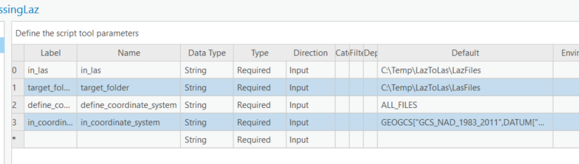

  1. I created a new Toolbox
  2. I created a New Script in the tool box
  3. I set 4 parameters in the Script and set defaults for them
    • Parameters                                        Default Values
    • in_las                                                  C:\Temp\LazToLas\LazFiles
    • target_folder                                       C:\Temp\LazToLas\LazFiles
    • define_coordinate_system              ALL_FILES
    • in_coordinate_system                     GEOGCS["GCS_NAD_1983_2011, DATUM["D_NAD_1983_2011",SPHEROID["GRS_1980",6378137.0,298.257222101]],PRIMEM["Greenwich",0.0],UNIT["Degree",0.0174532925199433]]
I put this code in the Script and when I double click the script in the toolbox it runs fine….Basically converting .laz files to .las files.

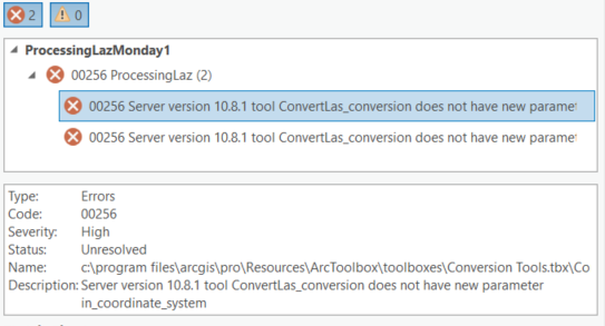

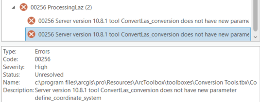

I then go to publish this GP Tool to my server and I get these two errors:
  • Server version 10.8.1 tool ConvertLas_conversion does not have new parameter in_coordinate_system
  • Server version 10.8.1 tool ConvertLas_conversion does not have new parameter define_coordinate_system
Why does this run via double clicking the script in the toolbox and fails when I try to publish this?  Errors above…..

Yeah it looks like the spatial reference parameters were added to the convert LAS tool at ArcGIS Server 10.9.
I believe you'll need to publish from ArcGIS Pro 2.7 or lower (ideally 2.7 or 2.6) to get that to work.

Hi there,
It might be the version of ArcGIS Server you've got (10.8.1) does not have those two parameters available yet, they may have been added at a later version.
What version of ArcGIS Pro are you using?
Take note of this when publishing geoprocessing services - https://pro.arcgis.com/en/pro-app/latest/help/analysis/geoprocessing/share-analysis/geoprocessing-se...

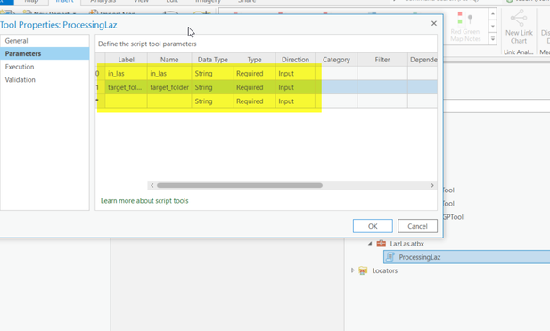

  • So I removed those two parameters from the tool properties
  • I removed them from my python code
  • I am still getting the error?
I am using ArcGISPro 2.9.5
We are on ArcGIS Server 10.8.1
Is this issue related to the version of Pro and Server?  One is expecting the 2 extra parameters and the other is expecting neither?
I thought by removing them from the script it would work but still getting the errors....
