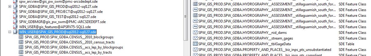

SteveCole
Honored Contributor
...and here's where things probably get messy. We have two connection possibilities, depending on if the user is simply just viewing data or if they are "editors" of data in the SDE. Here's the screenshot of the connection as an editor:
The other connection (view only) would appear as WIN_USER@[email protected]:
ChristianWells
In this case, you would have to make a connection as SPW_GDBA
SteveCole
