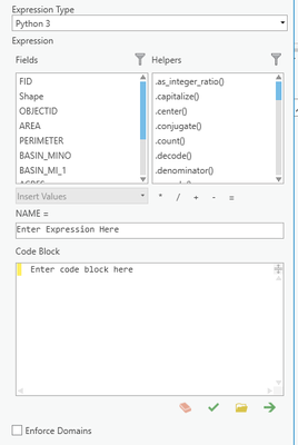

The syntax you are debugging is specific to using field calculator in Pro or ArcMap when updating a table's field (using the Python Expression Type).  You could try entering it there and testing it (I.E. the expression in the top box and the code block below like this)

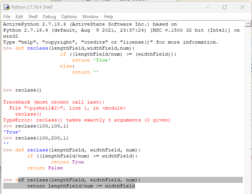

Here is a screenshot of my little test in Idle. After 1 minute of using Idle I want to use something else. 🙂

I was using the python interpreter tool for ArcMap. I attached a screen shot for you below. I was creating a script for some automation and was getting a generic syntax error when from the geoprocessing results window, so I was going line by line trying to troubleshoot it rather than running the tool over and over again with a few code changes each time I wanted to be able to change the one line I knew I was having a problem with for a quicker easier fix. Nothing fancy, I just knew I had a syntax problem with a specific line of code and couldn't figure out what the problem was.
