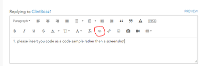

1. please insert you code as a code sample rather then a screenshot
