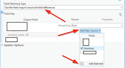

Hey @AlfredBaldenweck
I was able to find a way around it, I had to use the append tool along with a new source on the actual output of structure_name that I wanted to use, I've attached a screenshot of what I did. I converted the actual geoprocessing tool to Python using the drop down next to run and then input my variables and everything worked! (This was after the Copy Features, as structure is cut down)
Cody
