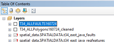

here is the content of mxd.
please help.

It appears that some of your data can't be located, hence the red ! marks
... sort of retired...
