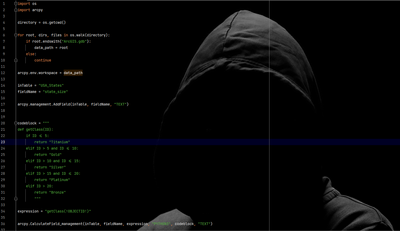

you should pass block of the code in the empty one based on the expression which wyou provided.
please check the below link to see more in details.
https://pro.arcgis.com/en/pro-app/latest/tool-reference/data-management/calculate-field.htm

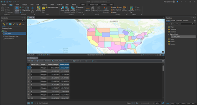

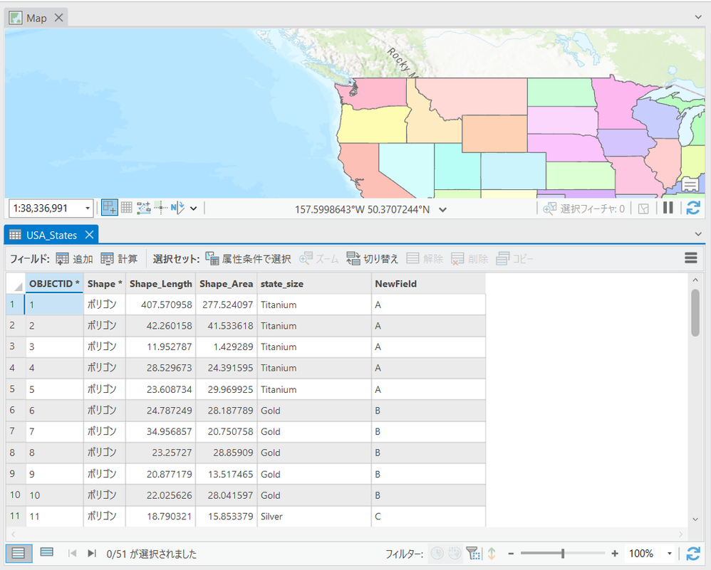

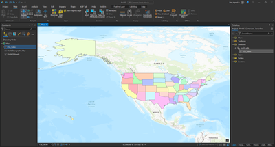

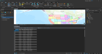

I have attached a simple python script with a simple ArcGIS Project to the attachment.
This project is creating a new field and based on OBJECTID puts a value to the new created field.
Please find some screens of the project and Python script and output of the script.
Good Luck

I tryed the script that you atatched, and that was educational!
The script was so simple that even I can understand.
I succeeded to fill a new field with  the values  I defined in the script.
