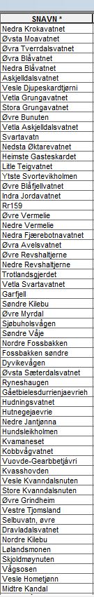

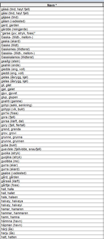

Thank you for the example and help so far, I'm uploading 2 screenshots from the tables to give you a better understanding of what I'm trying to compare. Table1 is to the left and Table2 to the right.
Table1Table2
XanderBakker
Esri Esteemed Contributor
Can you share (a portion of) the actual data. At first sight I don't see many matches in the screenshot you provided.

Since column1, Navn, can contain multiple terms/tags/tokens that you want to match; the SQL will get complicated enough that I don't know if every data store that ArcGIS supports will work.  I think working within Python will be the way to go.
Instead of a screenshot, can you export those to a text or CSV file and attach it?  As helpful as a screenshot can be, it is much easier to work with actual data than a picture of data.
JoshuaBixby
MVP Esteemed Contributor
Whether Python or SQL, you have a lot of conditions you are trying to work with.  For example, what does a comma and parentheses mean in column1?  Do commas separate multiple terms?  If so, do both terms need to be present to match column2?  What about parentheses?  What about the one row that is in quotes, is that one term or multiple terms?

The new output should show something like that yes, the text that is separated by comma in column1 is a diffraction of a word, that must both be checked against column2, as 1 object. So i need to have the code to treat comma as a delimiter to jump to next keyword.  The ones in parenthesis is just a short explanation in other languages, not important for the actual search. Column1 is a dictionary, while column2 is a placename base for a large area. I'm uploading the files here, but only a portion(50 000) of the 400 000 in table2 since its too big.

If I look at the data I kinda feel that the objective might be comparing "SNAVN" from the file Navn.csv against the field "field" from the file Ordbok.csv. That is just a guess and I don't we should be guessing...
There will be multiple hits either way and one should define what to do in that case. Lot of question marks before we can continue to write some code.
