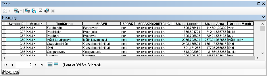

Hello, I'm currently working with one feature class table containing 400 000 objects and one database table containing 700 objects.  I'm currently working in ArcMap 10.4 and using a Geodatabase with Python 2.7. What I'm trying to do is match the database table containing 700 objects against the FC. What I want is to match them, treating all 700 objects as wildcars %700 ojects%, and match those towards the FC that contains text from the table.  I have 2 tables with 1 column in each that im trying to match. I have not yet found a good way to treat all rows in a column as wildcard to search against another column.
This is my code so far. This only will print out what the database table values. Next i wanted to get the FC values and compare them. I've read about maybe using a dictionary to make it easier to extract values but I've yet to figure out how.

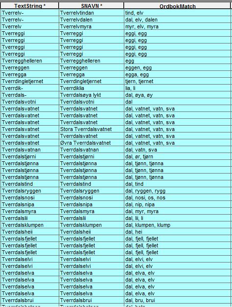

Hello, again, I'm currently working with the data and it seems that I have to make some changes to the script, to adapt it to the new parameters. Currently I want to search all text from "Ordbok" that have lowercase text and uppercase text differently. All text that starts with lowercase will be matched against text from "Navn" that's to the left of them and not both sides like earlier. The other text that starts with uppercase will only be matched against any text that's to the right. I tried looking through the script, but I'm not that versatile in Python yet, so I couldn't see where i should put the code for this. I'm guessing it's where "def FindMatches(lst_items, lst_dct):" starts, but again, I'm not sure. It would help me better understand what the script does as well so i can edit it later if needed.
XanderBakker
Esri Esteemed Contributor
Can you provide some examples of what is matched currently and how this should be changed?
Per_Olav_Kaasa
This is how it currently looks after using the script. As you can see with for example "Tverreggi" is matched against "eggi" and "egg". With the new method, it would only match against "eggi" since it wouldnt count the right side of the text as wildcard.
This is what i want(below), where as in the first example "Tverrdalstind" matched against both "dal" and "tind", it will now only match against "tind", since "dal" is not the end of the word and the new search will only check for wildcards on the left side of the text in "Ordbok", so if it has text on the right, it won't match. The other example shows text from "Ordbok" with capital letter at the start and therefore matches against the first part of the text "Nordrelandet" and "Nordre" since it only will search for the right side wildcards. This will give me fewer and more precise matches that I can use.
SNAVNOrdbokMatch
Tverrelvmyramyra
Tverrdalstindtind
NordrelandetNordre
Tverrdalstjønna
tjønna
Tverrdalselvaelva
XanderBakker
Thanks for the comprehensive explanation. If I understand correctly, when a value starts with an uppercase character, it should check the string using a "startswith" and when it is lowercase it should use "endswith".
It will check later what changes are required in the script to achieve this.
XanderBakker
I made some changes to the code and this is what I get as result:
