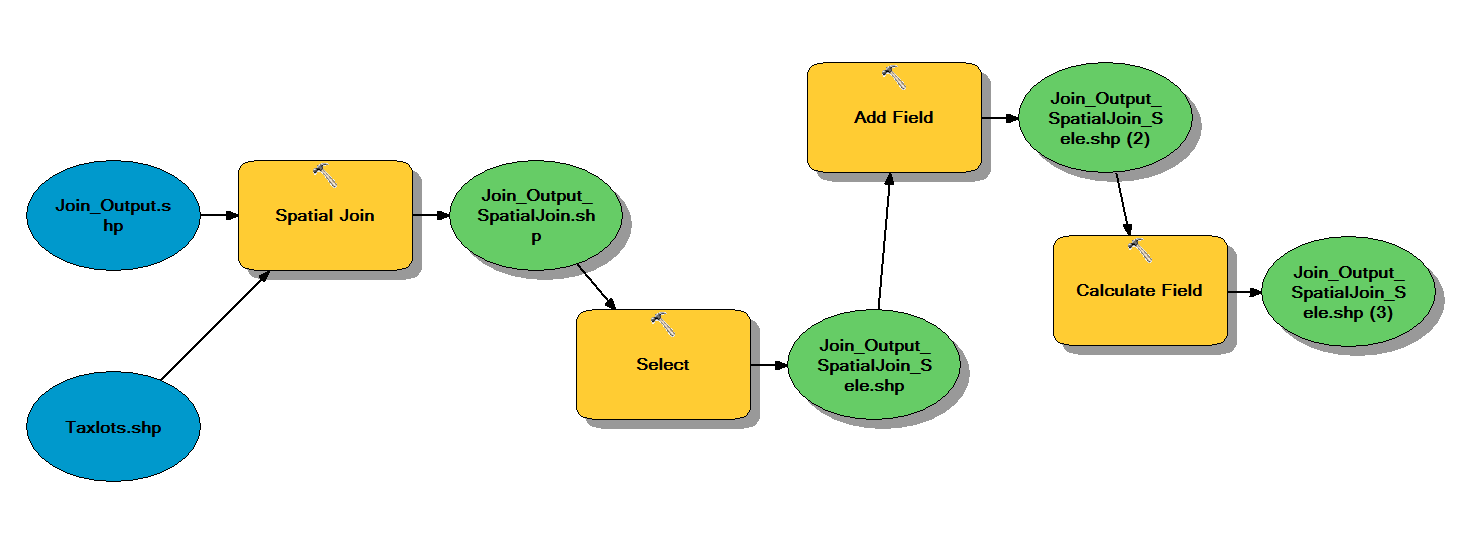

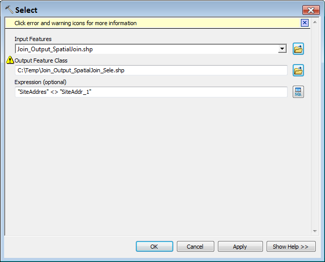

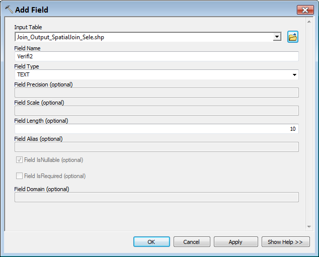

You could set up a model that does:
  1. Spatial join
  2. joins the spatial join with the tables
  3. Select the addresses that are <>
  4. You could then field calculate verified or field calculate the addresses
  5. remove the table join
or do your spatial join in model builder and export to python and use the resulting field as an input to the following script. The script prints the oids of the non matching of both feature classes you could easily modify to get what you need

WesMiller
Deactivated User
Add your field or create a copy and add a field then make your model similar to the one below.
