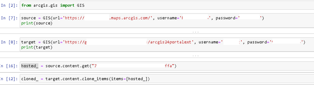

>>> src=app.login(app.username, app.password, app.source)
logged in
>>> trg = app.login(app.username2, app.password2, app.target)
logged in
>>> item = src.content.get(app.WEBMAP_012_H1_Map)
>> cloned = trg.content.clone_items(items=[item], search_existing_items=False, folder="TestFolder", copy_data=True)

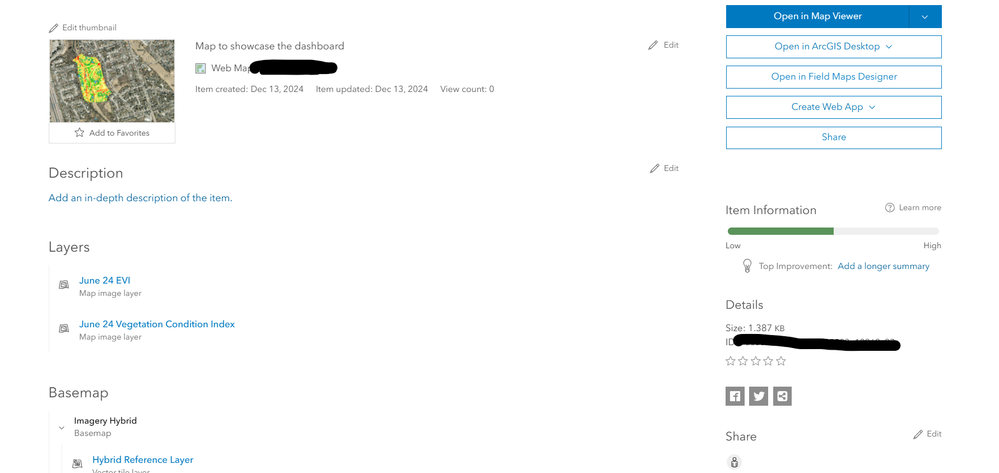

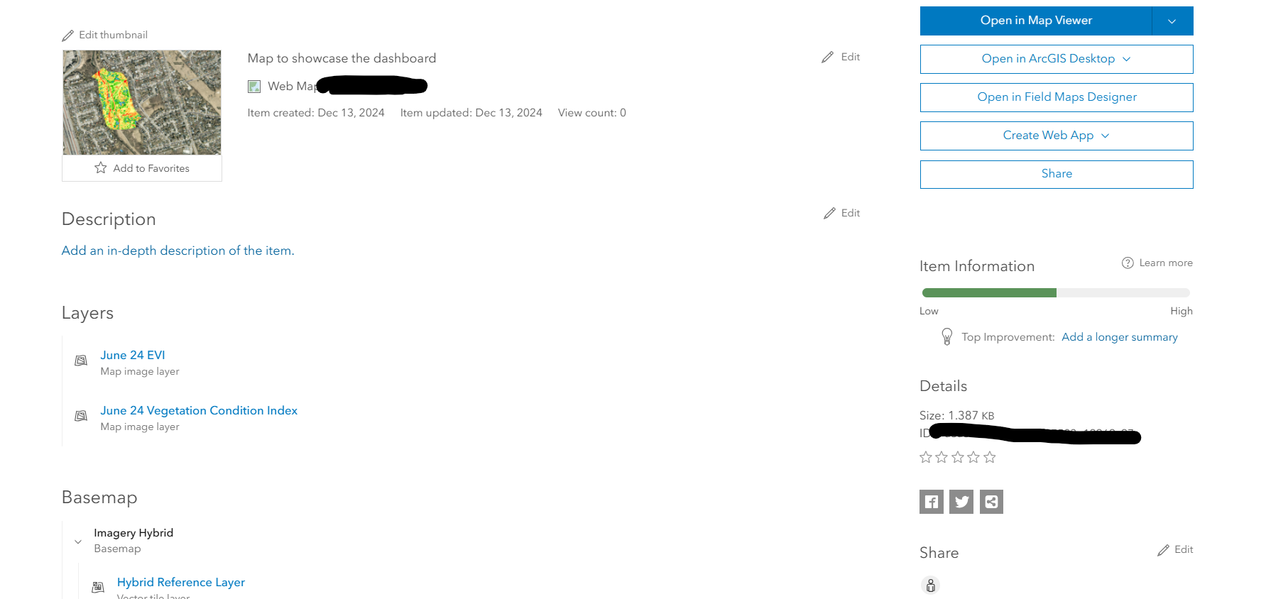

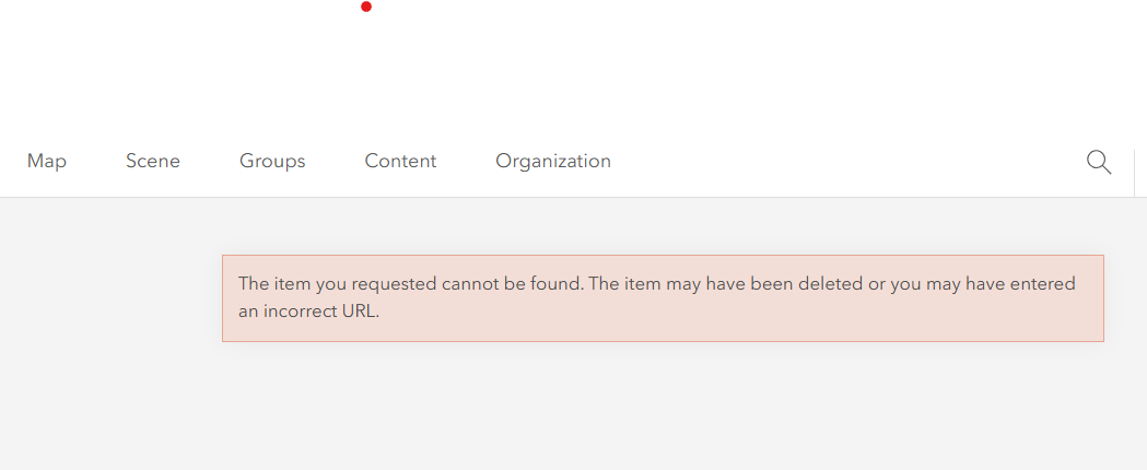

 The layers and what happens when I open one in target env:Screenshot 2024-12-13 081229.png
