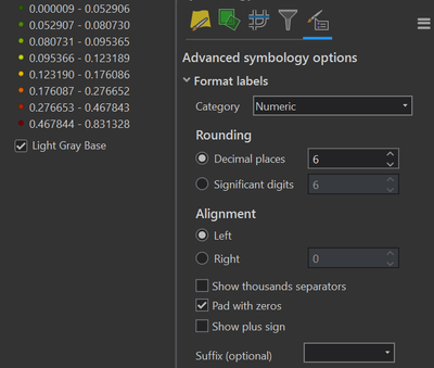

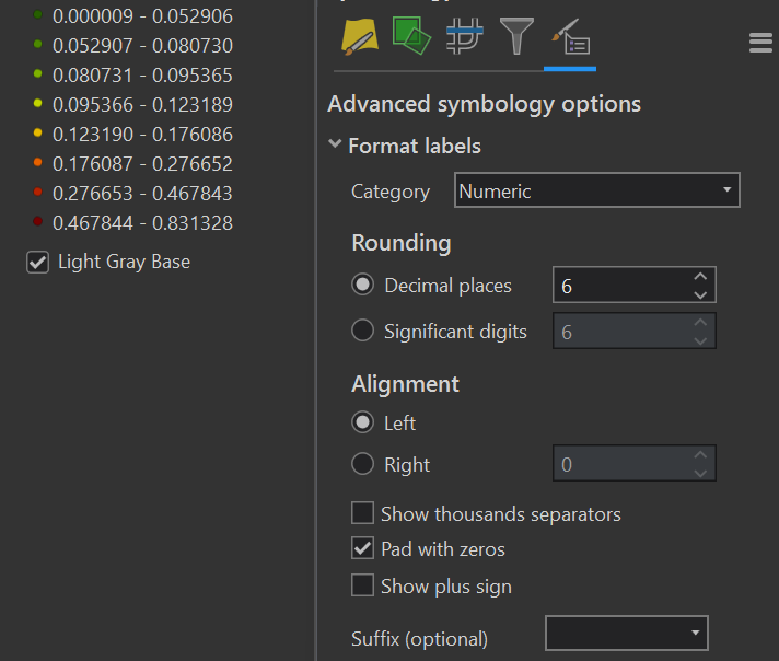

Before Running the Script:
(Actual legend on the left and the formatting setting on the right)

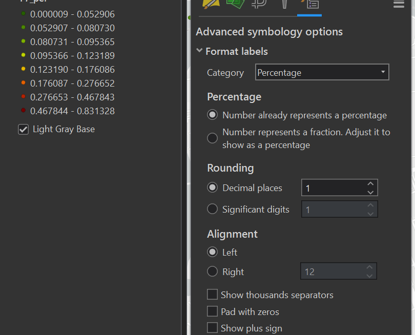

After Running the Script:
Category and decimal places changed on the right,
but the actual labels are the same as before

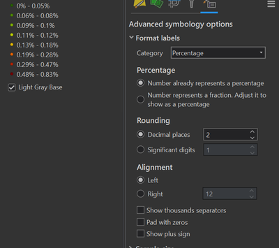

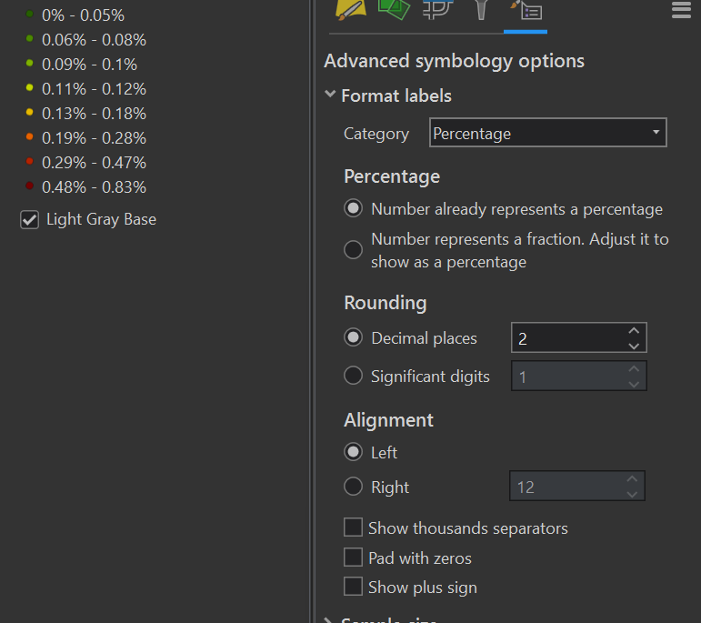

After Changing Decimal places to 2:
