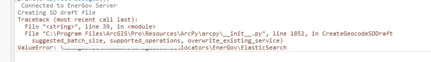

I have the following script to overwrite an existing locator service, in a standalone ArcGIS Server (10.9.1)
I'm getting the following error when creating the sd draft file
Below is the code

I'd venture to say that it is having problems with the way the paths are coded. The ValueError that you blanked out means that it's a bad value for what the tool expects.
I could be wrong, but I've never seen the paths start out from the c drive like \\c$.  I've always set the server server name like \\servername\\c$\\ or fullservername.com\\c$\\ to tell the script what c: do go to, even if its on the same server. Print out the full path and copy and paste it into explorer to see if it is valid.
You also have a space before the arcgis in the path, and a couple extra \\ before Staging that could be an issue as well:
sdFile ="\\\\c$\\Users\\AppData\\Local\\ESRI\\ArcGISPro\\\\Staging\\ arcgis

Thanks for catching the extra \\ on the sdFile variable.
I made a copy of the locator and moved it to a different folder.  The error message is the same with the updated folder path.
