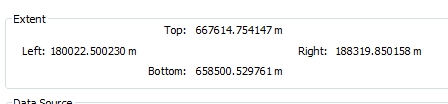

i don't understand what my mistake because the layer extent is:
thanks for any help.

Yaron_YosefCohen
but i have those values in the extent of the layer
DanPatterson_Retired
MVP Emeritus
see these variables map_Y_Max,  layer_Y_max ,  etc etc
they aren't defined in the code anywhere.  Python doesn't automagically assign numbers to variables, you have to assign them to those variables.
So you are either not showing all your code or you didn't assign numbers to those variables.
