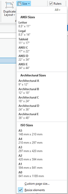

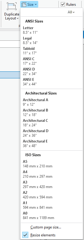

I am currently using ArcGis Pro 3.1 and in the Ribbon under the Layout section there is an option to change the Layout size while also resizing elements in the Layout. Is it possible to perform this same functionality from Python? I would like to be able to size the Layout to a specific size to fit polygons of varying size and have elements scale accordingly.

CIM access under
Python CIM access
There is a Layout class and all the related elements.  Not easy and not everything is open to access and/or change.

Thanks Dan!
I was hoping it would not have to be done manually since that functionality already exists in the user interface. I will take a look at using the CIM definition as I already use it for a few things in the project. I appreciate your time.
