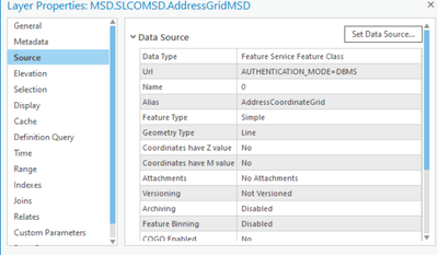

 When I run this as is, the properties of my feature layer looks like this:
Notice the value in the url row.  In the python code above, line 5 has 'authentication_mode': 'DBMS'  : if I leave that part out, it won't make any updates at all; the feature layer in the TOC still has the red exclamation mark in front of it. But when I leave it in, I get the weird properties value shown above.  In closing for today, if I list the connection properties through arcpy, it shows the sde connection properties but the feature url :

It appears to be pulling from the correct source, but I don't really want those other properties populated and I would really like the Properties pane to be accurate as well....
