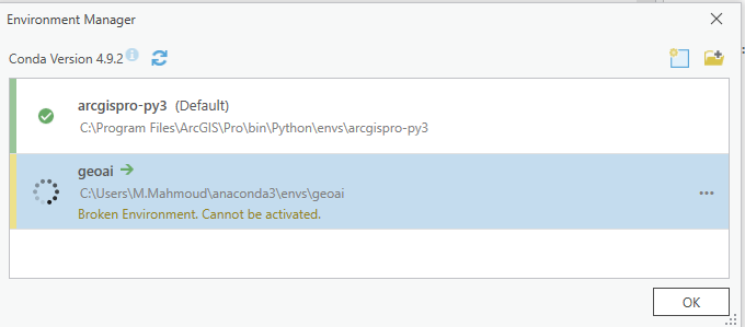

Last night, I was trying to learn about conda and environments and I did the introductory tutorial. The biggest issue was really running the Python Command Prompt as an administrator. So, I created a new environment from the Command Prompt using conda install --name and it appears to work just fine. However, when I try to activate it in ArcGIS Pro, it says it is Broken environment cannot be used.
I followed this steps but I still have this error" Broken environment cannot be used
is this steps Right to install new env and download Deep learning Library?
1-I installed New OS windows
2- download arcgis pro 3.0.0
3- update it to 3.0.1
4- open CMD as administrator
5- conda create --name geoai python 3.9.12
6- conda activate geoai
7- conda install -c esri arcgis
8-conda install -c esri deep-learning-essentials
9-conda install -c esri arcgis_learn python=3.9.12

DannyMcVey
Esri Alum
It looks like you're not installing correctly. You're creating a new environment from scratch when you should actually be cloning the arcgispro-py3 env that comes with Pro. Here is how you can get a deep-learning-essentials conda environment you can use with Pro:
from: deep-learning-frameworks/README.md at master · Esri/deep-learning-frameworks (github.com)
You can install the deep learning libraries from a command prompt using these steps:
1. Open the `Python Command Prompt` window
2. Clone the default Python environment with this command: (don't forget the `--pinned`)
    > `conda create -n your-clone-name --clone arcgispro-py3 --pinned
3. When the Python environment has been cloned, activate the cloned environment:
    > `activate your-clone-name`
4. Install the deep learning essentials libraries into your cloned environment with:
    > `conda install deep-learning-essentials`
5. Install arcgis_learn into your clone next with:
    > `conda install arcgis_learn`
Alternatively we recommend installing the Deep Learning Libraries Installer for ArcGIS Pro 3.0 (available here: https://github.com/Esri/deep-learning-frameworks/) which will install a verified set of working deep-learning-essentials packages directly into your arcgispro-py3 environment. Following this install your steps to get arcgis_learn installed would be:
