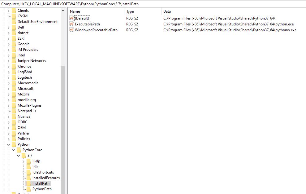

I see that it's going into both Python27 folder and an anaconda2 folder. When I go to my registry keys though, I don't see a python 2.7 folder and instead I see 3.7. I have set up my python interpreter in Visual Studio to point to the Python 2.7 interpreter and it works there so all good in VS. It's just the problem in ArcMap. I'm not sure what to do from here. Do I change the Default, Executable, and Window Executable all to point to Python27? It's worth noting that all the other tools I've been using in ArcMap work fine, it's just this one that I've had problems with so far.

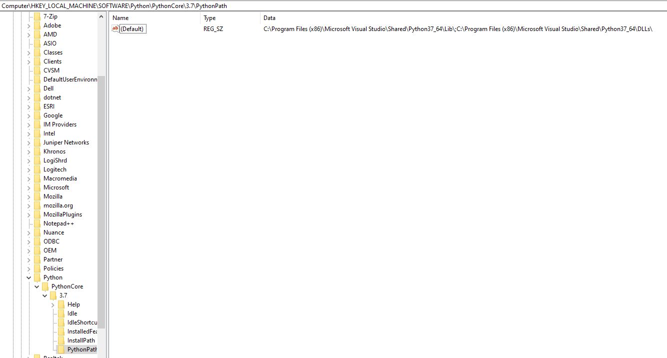

PythonPath folder has this in it:

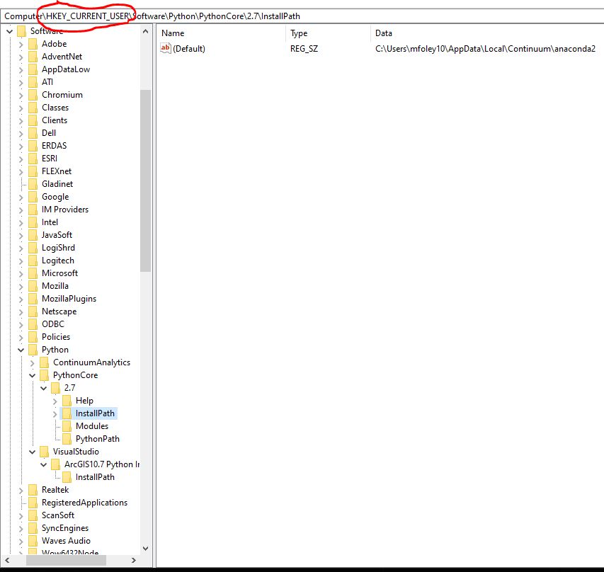

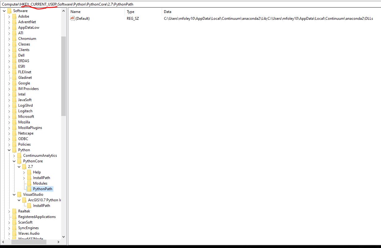

The above screenshots are in the HKEY_LOCAL_MACHINE. When I go to HKEY_CURRENT_USER, these are the install and python paths which point to anaconda. Maybe these are the ones I need to change? The Visual Studio ones are correct because I have those pointing to the ArcGIS interpreter:
Tags (1)
MKF62
So, I changed the path variables in the HKEY_CURRENT_USER (as seen in the original post, in the last two screenshots) to these:
InstallPath:
C:\Python27\ArcGIS10.7\‍
PythonPath:
C:\Python27\ArcGIS10.7\Lib;C:\Python27\ArcGIS10.7\DLLs\‍
It fixed the problem of being unable to use that tool so I'm going to tentatively say my answer is correct. However, I need to test with a few other things to see if I broke anything elsewhere...
InstallPath:
PythonPath:

I just fixed it. I don't know if it's broken anything else but I'm tentatively saying that changing the python paths for HKEY_CURRENT_USER (last two screenshots in the original post) to the Python27 paths fixed it.
You are correct though, expat still does not show up in the modules for me even though everything seems to be working now. Very curious indeed.
Edit: It has not broken anything else. I checked my scripts in PyCharm, Visual Studio, and Jupyter Notebooks and everything is working.
