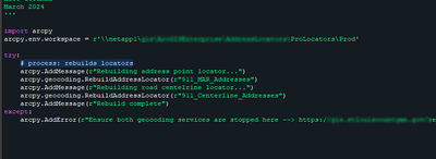

Hey all, running into an issue where I can rebuild a locator in Pro running the gp tool Rebuild Address Locator, but if I try to rebuild it in a script using arcpy, it doesn't work. I get 'Error 000005: Could not open the address locator' .
The rest of the code in my script publishing the locator and sharing it works fine, I just cant rebuild it. The execution block for this part of the script is about as simple as it can be as arcpy.geocoding.RebuildAddressLocator only has one argument, the locator path.
try:
    arcpy.geocoding.RebuildAddressLocator(locator_path)
    print("The geocoder was rebuilt successfully")
except arcpy.ExecuteError:
    print("Error rebuilding")
    print(arcpy.GetMessages(2))

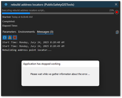

S
CortWilson

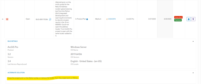

Support ended up logging a BUG for the issue I was facing.  It's in their product plan now, so it will be addressed at some point.
AaronManuel2
Huh, thanks Cort. Seems like their Bug report is saying the issue is trying to rebuild the locator if its also open in a pro project? I don't recall that specifically being my issue but maybe it was.
