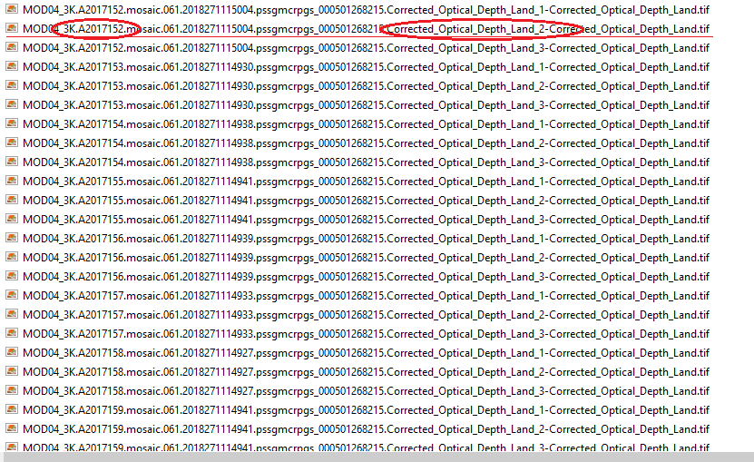

I have Julian day wise AOD data 2017/06 to 2018/05. Every day(...2017152...) have three files(...Land1, Land2, Land3), here we'll take only the land2 data after that I want to calculate the monthly average value from month wise data and save it in raster format with month wise by the loop. Before going to the average function we have some additional calculation is that every reading raster file first removes or deleting specific value ( less than 0 to -9999) and multiplied with 0.001 value, and then going to the Average calculation function.
When  I am running this code then there is some anomaly. like when I am processing the data specifying subsequent months of a year or years then it saves the output files haphazardly. For example, my desired years are 2017 and 2018. It picks all the file for the specified years, but it saves the output file for 2018 in 2017 file and along with its own output file.
kindly give me a resolution or any other alternative way, and also I want to set this code leap year also.
I have attached some sample data.

This code getting me this error. Can you explain line 23 and 30 to 35? Actually, I have 2015 to 2018 datasets I want to calculate the mean of each month and save it by their month and year name. Befor we go to the mean calculation have some additional calculation that I mention it in first.

Its ok but my question is how to extract the date from the Julian day that I want to save with raster name.
RandyBurton
MVP Alum
To work with Julian days:
>>> from datetime import datetime
>>> jdate = '2017152' # julian day extracted from filename
>>> datetime.strptime(jdate, '%Y%j').date().strftime("%Y") # 4 digit year
'2017'
>>> datetime.strptime(jdate, '%Y%j').date().strftime("%y") # 2 digit year
'17'
>>> datetime.strptime(jdate, '%Y%j').date().strftime("%m") # month
'06'
>>> datetime.strptime(jdate, '%Y%j').date().strftime("%d") # day
'01'
>>> datetime.strptime(jdate, '%Y%j').date() # as a datetime object
datetime.date(2017, 6, 1)
Since you may need to convert dates in several places in your code, you could make it a function.  You can pass a Julian day or the filename.
def parseJulian(jdate):
    dt = datetime.strptime(jdate, '%Y%j').date()
    return(dt.year, dt.month, dt.day)
def extractJulian(filename):
    jdate = filename.split(".")[1][1:] # get date portion, splitting on periods
x = parseJulian('2017152')
print x[0] #year: 2017
print x[1] #month: 6
print x[2] #day: 1
x = extractJulian('MOD04_3K.A2017152.mosaic.061.2017271115004.pssgmcrpgs_000501268215.Corrected_Optical_Depth_Land_2-Corrected_Optical_Depth.Land.tif')
print x[2] #day: 1‍‍‍‍‍‍‍‍‍‍‍‍‍‍‍‍‍‍‍‍‍‍‍‍‍‍‍‍‍‍‍‍‍‍‍‍‍‍‍‍‍‍‍‍‍‍‍‍‍‍‍‍‍‍‍‍‍‍‍‍‍‍‍‍‍‍‍‍‍‍‍‍‍‍‍‍‍‍‍‍‍‍‍‍‍‍‍‍‍‍‍‍‍‍‍‍‍
You could store this in your dictionary, with some code modification.  Basically you would insert the filename with the date information as a tuple. Dictionary would look something like:
{ 2017: { 0 : [('longfilename', year, month, day),...],...}...}
