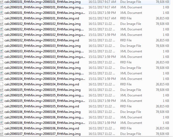

Hi everyone, I have folder with thousands of average daily relative humidity raster files that I would like to use cell statistics to calculate the mean in 8 day intervals. The data has dates in the format YYYYMMDD. I've looked at a similar code written after a similar question was asked but it doesnt do the 8 day averaging. I've included the link to the other answered question and a picture of what the data look like. Your help is greatly appreciated.Calculate daily average of raster files based on their names in python xander_bakkersample data

First thing I notice is the "+" sign in the name of the img files. This may generate problems when you use them in any mathematical operation in ArcGIS / Python. So it might be necessary to start with renaming the rasters and shorten the names. This can be done with Python. Would this be an option?

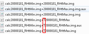

Edit:
I also notice that half of the raster have a "T" after the "+" sign. And 2 rasters will reference the same date. Should the 8 day calculation include 16 rasters?
LarryBiodun
Hi Xander, thanks for your quick response. That was an error in that sample list i sent. Thanks for picking that up. The 8 day calculation should only include 8 rasters. I have included another pix of the actual correct data. I am happy to shorten the names. Infact anything after the first 14 characters dont matter.data2
