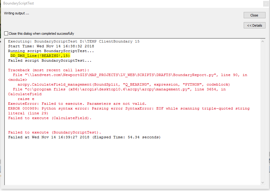

I've spent quite a bit of time looking at all the similar issues on GeoNet and Stack Exchange but I still can't find an answer. I'm sure that someone will be quick to say that I should use a cursor, but this exact same code works in ModelBuilder just fine!
Is there the potential for a carriage return or something? I copied and pasted my codeblock so that might be a possibility.  Here's my code (the FC in question does indeed have a field called 'BEARING'):

My expression appears to be fine (highlighted in this image).
ugh, been banging my head against the wall on this one!

try triple single quotes to enclose you code block because you are using double quotes throughout the scripts, it is probably fouled up
your script block
or change all your double quotes to single quotes in the script... (the former is probably quicker )

Dan Patterson‌ After a really long day I came home to try your fix, but to no avail. I was very hopeful on this one too! Same error.
i wonder if i try to format my notation statement? too bad because it did work in the model builder prototype but it's probably some kinda issue with quote escaping (although that lingering thing about copying and pasting the code block is bugging me too, i'll redo that but remote access is slow tonight).

Dan thanks for the heads-up on the Jive formatting. I looked back at my code and I do have the indentations. However, I did modify the beginning and end of the codeblock a bit. I know images are generally frowned upon when relaying code, but given the formatting issue I'm adding this for verification. Still have the same error:
UPDATE: after much picking away it does appear that something is wrong with the 'notation' statement or at least something isn't happy there. If I reduce it down to just  notation = prefix + str(degrees) the output is fine. Admittedly the output is a bit over-complicated (but it works in model builder) .
Is there a way to insert another string formatting statement w/in the codeblock? I may try that fresh in the AM.

Dan Patterson‌ Dan, are you familiar with the proverb For Want of a Nail?
Notice that one slight change I underlined? jeez...
And the output:
Thanks for sticking with me on this one! In the end you were right...it was ultimately about quotes
