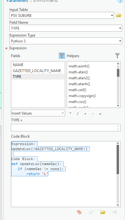

(i"m new to arcpy and arcgispro)
I'm attempting to use the Calculate Field to update a column based on non-null values in another column:
Expression:
UpdateLoc(!GAZETTED_LOCALITY_NAME!)
Code Block:
def UpdateLoc(nameGaz):
    if (nameGaz != none):
        return 'L'
(I've tried != NULL and IS NOT NULL as well)
I'm not sure where I am going wrong here, I get '2 parameters are missing or invalid'

For this type of basic conditional check, you don't need a code block.  Set the parser to Python and try the following expression:
'L' if !GAZETTED_LOCALITY_NAME! is not None else None‍‍
NULL in databases and data stores gets mapped to Python None.

and if you want to use your code block, you don't include the …. Expression : nor the Code block lines,
Underneath Type (which is the field you are trying to calculate values for, you put the expression in there
Type:
Then in the code block section
Code Block
    if nameGaz is not None:
        return 'L'‍‍‍
    return None
code blocks and expression lines take a bit of getting used to.
If you reuse and expression a lot, you can save them a *.cal files, and then reload them
deleted-user-1sAsOmMajBua
Deactivated User
Thanks for that - it wasn't clear what went in what box from the example I ripped off (Calculate Field Python examples—Data Management toolbox | ArcGIS Desktop ).
