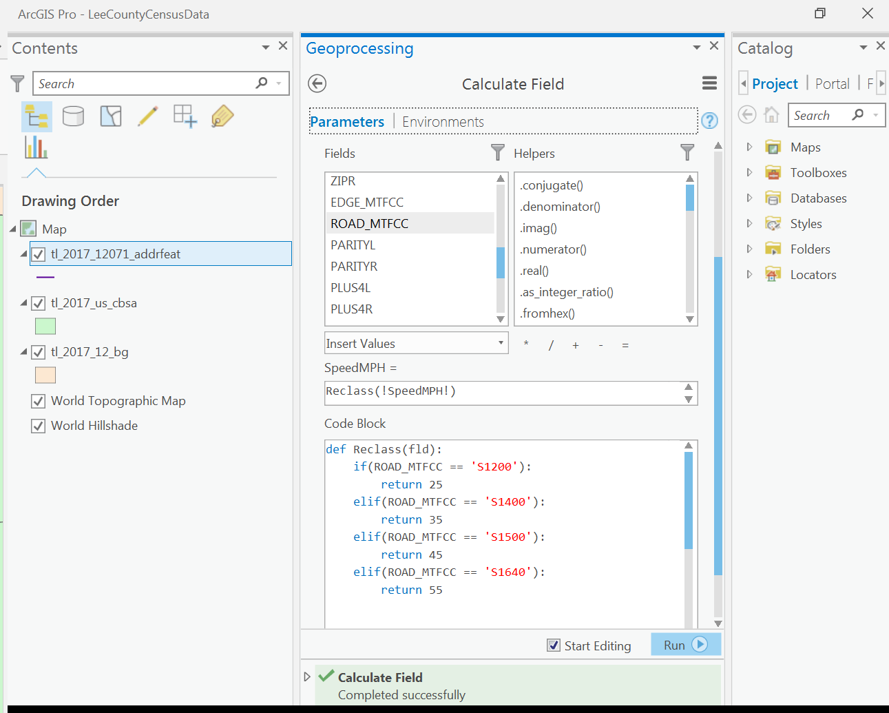

I am working on a TIGER line file of roads in my county in shapefile format (although I am having the same problem with geodatabase format). I am attempting to update a created field named SpeedMPH based on another field. If the field named ROAD_MTFCC is equal to S1200 then update the SpeedMPH field to 25. My code block is written in Python 3.6 and I am running ArcGIS Pro 2.2.1 with the latest updates. My code block is:
def Reclass(fld):
if(ROAD_MTFCC == 'S1200'):
return 25
elif(ROAD_MTFCC == 'S1400'):
return 35
elif(ROAD_MTFCC == 'S1500'):
return 45
elif(ROAD_MTFCC == 'S1640'):
return 55
I then click the green check to verify my code and it is accepted. I click the run button and it runs for a few seconds. When I look at my TIGER line file of roads attribute table the SpeedMPH field is NULL. Nothing was updated.
What am I doing wrong?
Enclosed is a picture of the Calculate field window and a 7zip of my TIGER line shapefile. It is pretty standard Census data.if then code block Python
RandyBurton
MVP Alum
Pass ROAD_MTFCC to your function, and in your function reference fld.
Reclass(!ROAD_MTFCC!)
