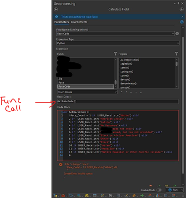

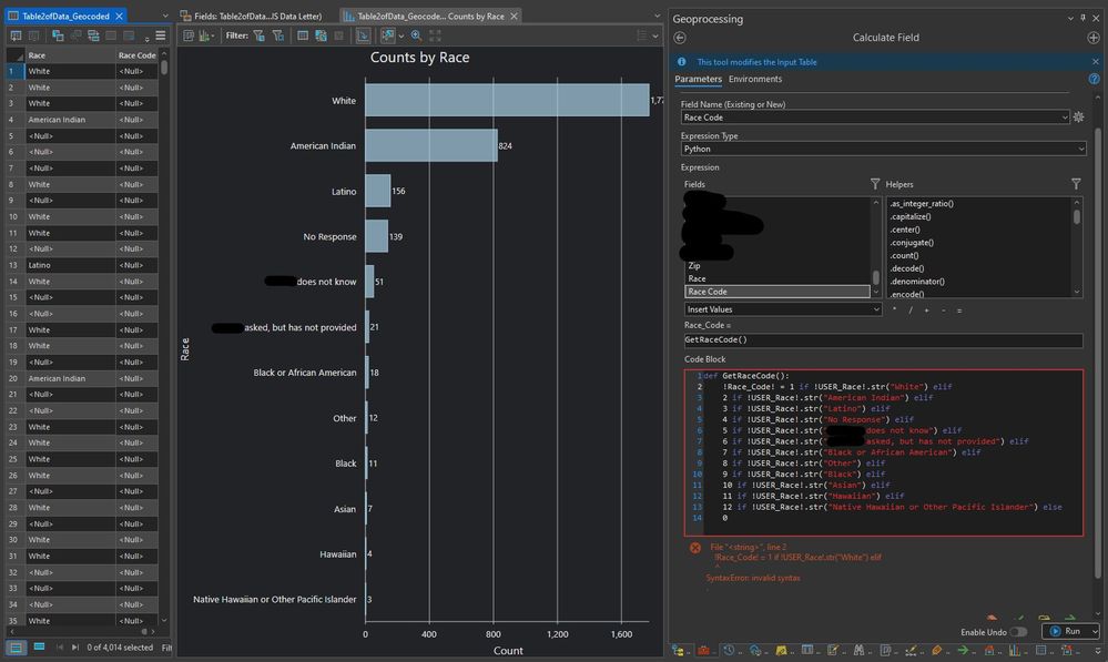

I am trying to convert Race or Ethnicity values into a numeric code for them. For example, "White" would equal "0" , and "American Indian" would equal "1" , and "Latino" would equal "2", and so on and so forth.
I attached a screenshot and inbedded a photo below, that shows my attempt to do this, but I failed miserably. I've been looking online for over 1.5 hours now trying to find an answer or similar example I could go off of but have had no luck.
MErikReedAugusta
MVP Regular Contributor
Looks like you've got some basic syntax problems in your code.
To start with, python is indentation-based, and if/elif/else groups should all share the same indentation level.  The actions inside those if/elif/else conditions are one indentation level down from there.  Also, you do your condition, then your action, like so:

Second, the field-names-with-exclamation-points thing isn't actually valid python.  It's a weird choice ESRI made with the outer layer of the interpreter and is only valid in the function call.  It will always throw an error if you put it in the code block.  This is one of my many gripes with the implementation of Field Calculator.
Lastly, this could be done quite a bit more simply with a list or dictionary lookup.
Try this code in the function call line:
GetRaceCode(!USER_Race!)

RyanUthoff
My screenshot below should work correctly. If you're writing your number values to a string field, then make sure to put quotes around the numbers.
I don't know how to properly explain it, but your Code Block cannot "see" your fields. You can't directly reference them using !Field_Name! syntax. Instead, you have to pass those fields to it from the line above. And then you reference your fields that way. Hopefully my screenshot will help explain it.
From there, you just have your if statements to calculate your values. And then at the very end, you need to return the value of "Race_Code" so it can calculate value in your table.
