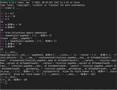

Oddly enough, your name works in all instances I've tested:
That full stack trace is throwing an error when the 'newDict' (likely a Python dictionary) is being unpacked into a named tuple. For some reason this operation is causing the attribute error.
