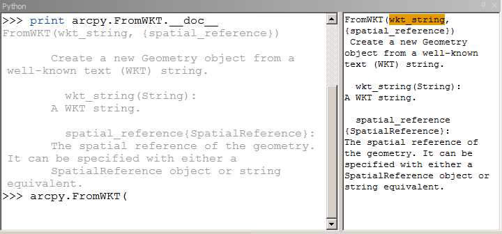

It turns out, the interactive Python Window doesn't properly show the __doc__ special attribute in the Help Window for Python classes or functions/methods within classes.  For example, let's look at arcpy.FromWKT:
You can see that ArcGIS Desktop is displaying the __doc__ special attribute in the Python Help Window.  Now let's look at arcpy.Polygon:

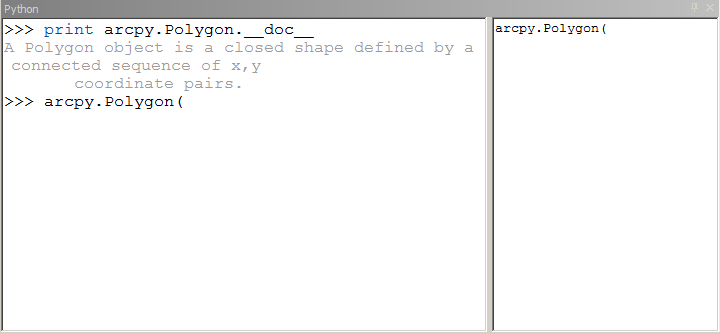

Although the __doc__ special attribute isn't overly verbose or detailed like with arcpy.FromWKT, there is nothing being displayed in the Python Help Window.  For the longest time, I couldn't figure out what differentiated the former from the latter.  The answer, Python classes.  arcpy.FromWKT is a function defined at the module level whereas arcpy.Polygon is a class.  Furthermore, for functions/methods defined within a class, the __doc__ special attribute isn't displayed either.

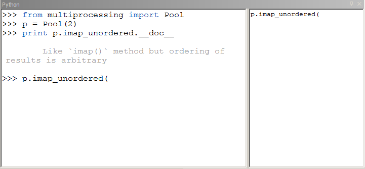

For ArcPy itself, the impact is noticeable, but whether it is significant or not is debatable.  The real issue arises because the interactive Python Window doesn't behave this way just for ArcPy but for all Python packages.  For example, look at the multiprocessing module:
For some Python packages, this bug/oversight has minimal impact, but there are other Python packages where a significant amount of useful documentation doesn't show up in the Python Help Window.
