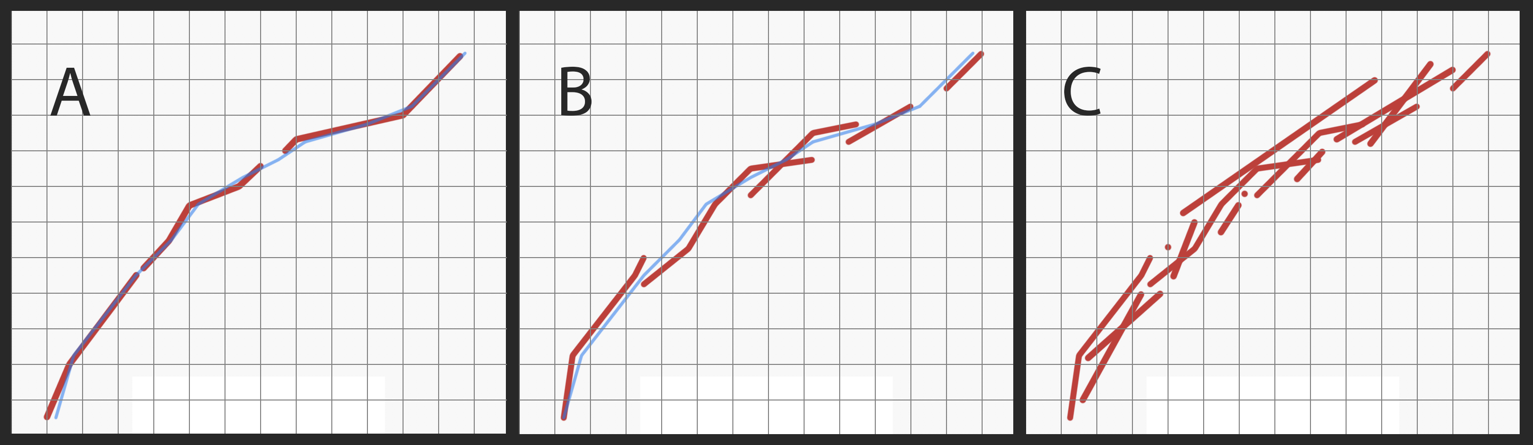

During development, I was provided with test data which was all nearly ideal (and ordered). No two SubRoutes overlapped, and each began near where the last one ended. I was able to simply append each line together to get one perfect line.  The test data looked similar to Graph A in the attached image.
Now, Im looking at the real-world data and it looks more like Graph B, with the potential to look like Graph C or worse. Obviously, my previous approach won't work at all. Now I'm kind of stuck.
How would I take a group of lines, and create one composite line to represent the "average" (for lack of better words) of all of the lines? The blue line in Graphs A and B is what I am looking for.

Examples A, B, and C

buffer your polylines by a finite amount to collapse the inter-line space
convert the buffer to a centerline
Polygon To Centerline—Topographic Production toolbox | ArcGIS Desktop
good first start
