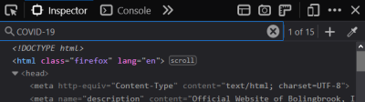

When I do a CTRL+F for "COVID-19" on the webpage I get a count of 5 occurrences. When I do a CTRL+F for "COVID-19" in the Developer tools I get 15.
I'm trying to get the count for the total occurrences of the string "COVID-19". How can I set up the code to do that?

JaredPilbeam2
MVP Alum
You're right. That's exactly what I did. I put the print statement in, and simply counted the results. There are 8 of them. I was thinking it was counting the length of "COVID-19" because there are 8 characters there too.
#printed this
COVID-19 Message
Village of Bolingbrook COVID-19 Update 05.06.20
COVID-19 Message
The Village of Bolingbrook has been in constant communication with both Amita Bolingbrook Hospital and Edward Hospital, along with the Will County and Illinois Department of Public Health to monitor the possible spread of the Coronavirus (COVID-19) in the Bolingbrook area. We are following the most current recommendations for treatment and preventing the potential spread of infection. Protective equipment and procedures are in place to provide emergency medical treatment and safe transport of individuals to the hospital.
COVID-19 HELP
Will County COVID-19 Cases
Here in Northern Illinois, we have had 41 blood drives canceled due to coronavirus concerns, resulting in approximately 1,500 uncollected blood donations.  As the number of COVID-19 cases grow, we do expect that number to increase unfortunately.  That’s why we are asking organizations to please keep their blood drives and for donors to continue to give.  Together, we must ensure a readily available blood supply for patients who are counting on us.‍‍‍‍‍‍‍‍‍‍‍‍‍‍‍‍‍‍
Also, good point. CTRL+F in the developer tools seems to not be case-sensitive. I'll go ahead and mark your answer correct since it was the closest thing to my not-so-clear question.
