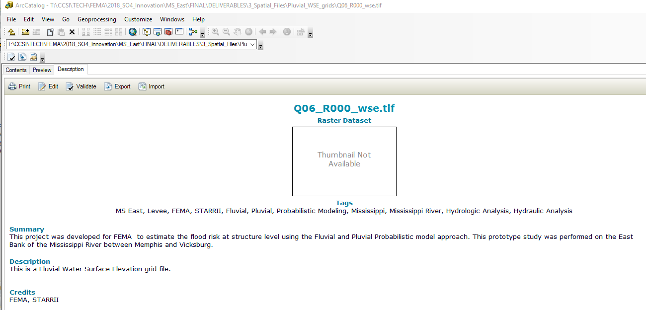

I am trying to write a Python script (or find a tool) to batch process metadata for a raster dataset. I have a folder with about 300 .tff files. I want to be able to go into ArcCatalog and see the standard (or FGDC) item description metadata for each of these files.
Without creating a literal .xml file for each .tiff file, I am currently trying out the arcpy_metadata module (for Python 2.7 only right now). Is there a simpler way to do this using a tool? I've seen more complicated scripts using the lxml library. Would it better to go that route?

Hey Guys,
     I was actually able to get this working using the arcpy_metadata mod/library. It's super simple, but has some limitations. 1) It only runs with Python 2.7, 2) It's 32-bit, 3) It can't add spatial reference or extent elements (also some of the contact data is a little wonky). Other than that, I made some loops to iterate through the target folder, some conditionals to handle for different file types (only works on features, .lyrs, .shp, and raster datasets). Handling some of these file types is a little difficult but for limited use, it works pretty good.
