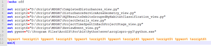

Hello,
I am looking to do something very similar here. I have 6 individual scripts that I would like to have a .bat file kick off. However, my current .bat file is just executing the first script and not the others. The scripts are NOT dependent on each other, but it would be nice to record any script that fails.
Here is what I have in my .bat file:
