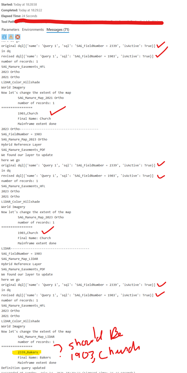

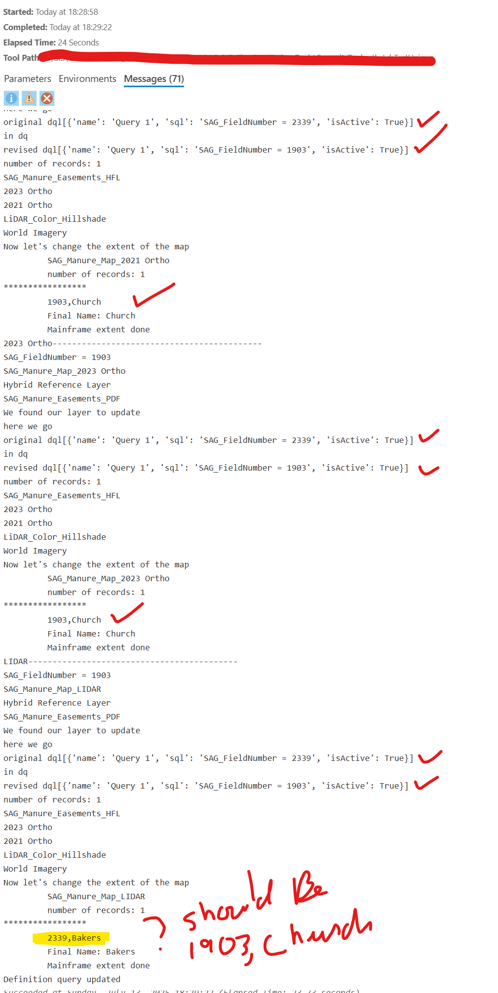

Hello,
I created a script that loop through 3 maps, update a definition query based on a parameter then change the extent of the layout and export the layout to PDF. It's "kind of working" however, every time I run the process ONE map (never the same) get stuck on the extent of the previous selection. Below is the code and the details info the process.
Weird thing is if I look in all 3 maps, the query definition has been updated...

This is the details from the proces
 I looked at this for too long:(
Any help would be much appreciated

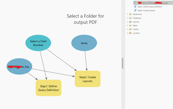

DominicRobergeIADOT
Thanks @TonyAlmeida but that didn't solved my issue. I also tried to create a function just for the query definition that didn't help either.
So I ended up splitting the code into 2 scripts: Step 1 create the query definition, Step2 update the layouts and PDF. Using a Mode Builder I can run both scripts at the same time and no issue.
I would love to get the code to run into 1 script but whatever works for now.
