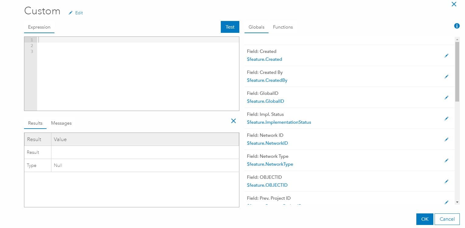

Yea removing line 10 took out the error for unexpected identifier, however with this code now for Attribute Expressions, i get the execution error: runtime error: cannot call member property on object of this type. I'm fairly new to Arcade and such and do not understand these errors. Any assistance on this bit then?
// #FAAF41 Primary Color
var primaryColor = "#FAAF41";
var networkID = $feature.NetworkID;
var color = primaryColor[networkID];
Console(color);
return color
