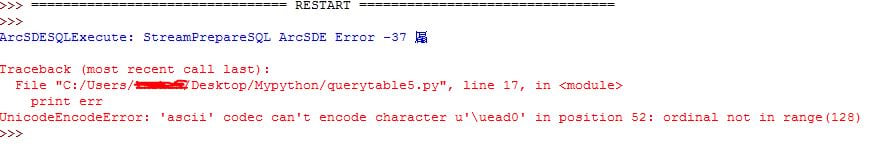

I tried to join the three tables and select the records from the table in one of our arcsde database using python scripts, however I got a traceback error indicating "ArcSDESQLExecute: StreamPrepareSQL ArcSDE Error -37 ". I don't have any clue how to fix this error. Interestingly, when I join the two tables and run the query, it works well. Here is the snippet that gives error when run the query for three tables:

According to the ArcSDE return codes:
SE_TABLE_NOEXIST (-37)
The specified DBMS table does not exist.
Are you sure the syntax with the 3rd table is correct?  Have you tried executing the SQL outside of ArcGIS to see if it returns an error?
KushendraShah1
I tried and run outside of ArcGIS and it works well. Actually my 3rd table was not correct(made typo). Also, I used the 3rd table for a feature class, it seems like ArcSDESQL doesn't work for spatial column. I got an error of "ArcSDESQLExecute: StreamBindOutputColumn ArcSDE Error -65". I know some of the columns has null values in them. It would be great if I can perform join in Spatial data not just tables and perform query to extract the information. Thank you so much for getting into this Joshua. I appreciated for the help.
