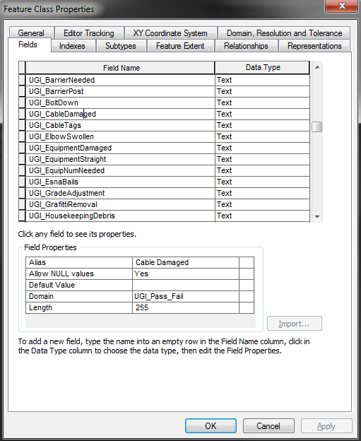

In your screenshot, are those all the common columns in the feature classes?  Do you also want to add new columns to the merged feature class?
EddyClark
Thanks for your reply and sorry for the confusion.  I'm new to python and scripting in general.  Line #25 I did butcher for this post.
Yes, my screenshot is showing common columns in the 16 feature classes.  All 16 feature classes get inspected for all the same things - we just keep them separated because they're different features (Poles vs. Transformers vs. Capacitors, etc).
My thought is that the "MergedFeatureClass" will have an additional 3-4 fields, on top of [From_FC_Name].  Those 3-4 additional fields would be named [FirstFailure], [SecondFailure], [ThirdFailure], etcRarely does an inspection have more than one fail.
So if CapacitorFeatureClass fails in the [UGI_GraffitiRemoval] column then I want the row under MergedFeatureClass' [FirstFailure] column to contain the attribute of "UGI_GraffitiRemoval".  If Capacitor fails UGI_GraffitiRemoval and UGI_BarrierNeeded, then [FirstFailure] and [SecondFailure] would get populated with the respective column name.
